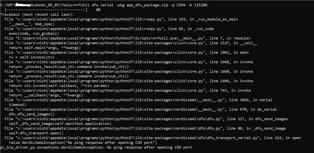

This is the error I have. Couldn't figure out what causes this error. Tried all the related issues mentioned on this website.
I have made sure the python and latest version pip is installed.

    Sounds like the problem is that the board isn't entering DFU mode for some reason. Is there any chance the serial bootloader may have been erased from the board? Also, is the bootloader provided by Adafruit, or have you built it yourself from the nRF5 SDK? The "no ping" error indicates that the bootloader didn't receive the ping request.

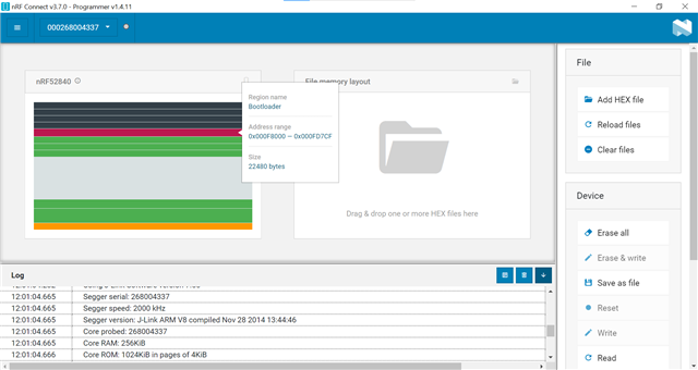

  • Please try to program the Master boot record (MBR) as well, in case it's not included in your bootloader hex file. This section is needed for the bootup process (bootloader will never start without it)
    Bootloader memory layout
    MBR hex (from \nRF5_SDK_17.0.2_d674dde\components\softdevice\mbr\hex)
    0552.mbr_nrf52_2.4.1_mbr.hex

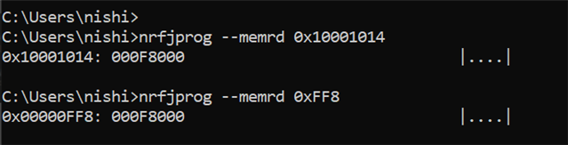

    If it still doesn't work, then you have to try debug the device to find out why it's not entering DFU mode. For example, run 'nrfjprog --readregs' to see if the CPU registers may provide some clues as to what's wrong. The CPU program counter (PC) register will for instance tell what address the CPU is executing code at.
