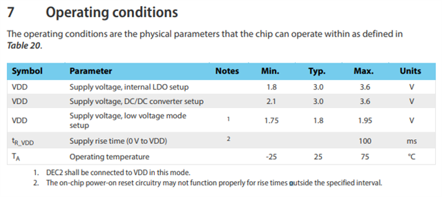

    A few things come to mind. Likely the internal power en reset does not trigger as expected. Do you have any measurement on the time to ramp up VDD during charging? There is a max 60ms rise time I believe allowed by spec.

  • Please measure the VDD ramp up time when charging to confirm if rise time is within specification.

    1.) Please let me know where I can find this VDD ramp up spec.

    1.) I have completed the VDD ramp test.  It is up to full voltatge within 300uS, as I suspected.

  • Here is a snippet from the spec:
    Based on your current description I am not quite able to understand what may be causing your problems here, are you able to share schematic of the design? It is possible that the nRF51 is actually starting running code, but it stops during initialization due to code is waiting for something (e.g. external sensors), can you add a LED blink on the start of main() to check for this?
    Can you share a plot of VDD when it starts to charge? I just want to check if there is something we are missing here.
