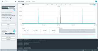

We followed the user guide to test the current but I am getting ~1mA current which too high. Setup tested using multi meter as well as power profile kit. (Current remains ~1mA)

- Power profile kit image while measuring current. we can see that we have peak current of around 40mA and the average seems to be the same as ~1mA.

    Most likely, the increased current is caused by the UART peripheral and EasyDMA. Try disabling the UART peripheral, to see if you get lowered current consumption.

    As you suggested, I have removed the UART from code and I can see that current  ~33uA.
