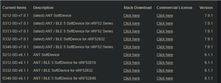

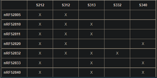

Nordic's docs for SDK 17.0.2 state that S312 v6.1.1 is supported, and doesn't mention v7.0.1. On the other hand, thisisant.com states that v6.1.1 is for nRF52810, and says that v7.0.1 is for nRF52 and is "compatible with the latest nRF5 SDK".
    Thisisant is more update regarding this information since they own and release S3xx softdevices. According to thisisant info
    You should be able to use latest S312v7.0.1 on nRF52832 but you might have to change RAM/ROM settings in your IDE in the examples to accomodate new softdevice ROM/RAM usage which you can find in the S312 release notes.
