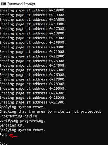

  • Hi Amanda,
    I load the image by dragging the .hex file into JLINK interface iof the PCA10040 board
    BTW: It work fine for all the other example except with the UART.
    Yes I download the .hex example file from nRF5_SDK_17.0.2 SDK directory as it is.
    I tried also to build the image by SEGGER  and download it ...with same result. No adversing and LED1 and 2 steady ON.
    I tried also your suggestion using command line tool but the result is the same.
    Neither in the Putty terminal text like "UART started" is shown
    Is someone experienced my same issue with PCA10040 board and UART example?

    Can you try another DK, pc, usb cable, or phone?
    Do you connect to the used COM port with the following UART settings?
    • Baud rate: 115.200
    • 8 data bits
    • 1 stop bit
    • No parity
    • HW flow control: None
    Suggest programming the board with Sgger or command line tool.
     I would suggest to enable the NRF_LOG_BACKEND_RTT_ENABLED (1), disable NRF_FPRINTF_FLAG_AUTOMATIC_CR_ON_LF_ENABLED (0) and building with debug mode to check the debug log. Is it possible to provide the debug log?
    -Amanda H.
