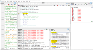

    after connected to iphone and uart notify enabled
    after 4 to 7 mins the device get restart and during debug found
