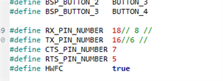

I have downloaded the DTM firmware and connected it according to the serial port pins defined in the figure below,
The selection of GPIO pins are pin 18 for RX and pin 16 for TX.but it keep getting error:Can not communicate with device. Make sure it is not in use by another application and that it has a Direct Test Mode compatible firmware when start test DTM with nrf conncet.
But the same firmware, using the 52832 development board does not have this error.
Please give me some suggestions what should i do.

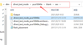

    actually, I know I should to compile the project "pca10040e",and i had compiled the "pca10040e" project for nRF52810 devices.
    but I still getr that error: Can not communicate with device. Make sure it is not in use by another application and that it has a Direct Test Mode compatible firmware.
    I really have no idea to solve this problem, please give me more help.
