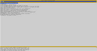

  • Hi Xinjiang
    Try to debug using "ninja menuconfig".
    To debug project configuration using ninja menuconfig, follow these steps:
    1. Build the project as normal, for example using Segger Embedded Studio.
    2.Use nRF Connect Toolchain Manager to "Open command prompt"
    3. Use terminal to navigate to the build folder for the project, using the "cd" command.
    Below is an example for navigating to build folder for central_uart example. Your path may be different.
    $ C:\PATH_TO_NCS\v1.6.1\>
    $ C:\PATH_TO_NCS\v1.6.1\>cd nrf\samples\bluetooth\central_uart\build_nrf52840dk_nrf52840
    $ C:\PATH_TO_NCS\v1.6.1\nrf\samples\bluetooth\central_uart\build_nrf52840dk_nrf52840>
    4. Use the command "ninja menuconfig":
    $ C:\PATH_TO_NCS\v1.6.1\nrf\samples\bluetooth\central_uart\build_nrf52840dk_nrf52840> ninja menuconfig
    Then you will see this screen:
    5. Search for the symbol you want using "/".
    Example on search for "MINIMAL":
    6. Navigate to symbol you want to know more about and press Enter to go to configuration destination.

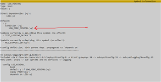

    7. Press "?" on the symbol to see more about this configuration. Here you can see what configuration is set to, as well as the default value, and what other configurations have set this config. Arrow shows that in this example, LOG_MODE_MINIMAL has is "y", which makes LOG_MINIMAL "y" as well

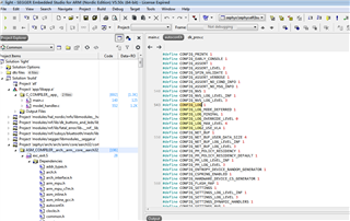

  • Can you tell me why ncs1.6.0 does not show CONFIG_LOG in prj.conf in the current project directory, but CONFIG_LOG is enabled. Where are the changes in ncs1.6.0 compared with ncs1.5.0.
  • Hi
    For changes to NCS, see NCS Release Notes.
    Eventually, for more detailed changes to the codebase, you could have a look at the git history for the file.
    Using the method I explained in the last answer, I found the following for nrf/samples/bluetooth/mesh/light configuration:
    It looks like CONFIG_LOG is set by CONFIG_NCS_SAMPLES_DEFAULTS.
    Sigurd Hellesvik
  • Thank you for reminding me. I forgot the CONFIG_NCS_SAMPLES_DEFAULTS at the beginning of prj.conf.
