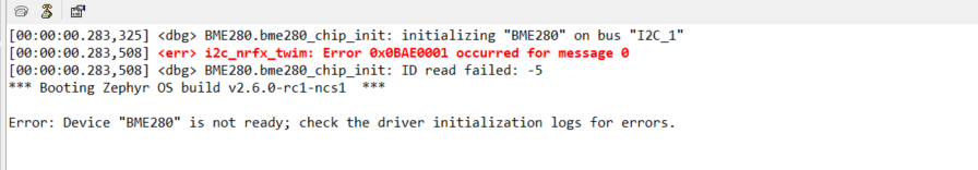

i'm using NRF5340 kit and trying to display ( H,T,P) values with the BME280 sensor
but i'm getting this error
i'm recently having an issue with the display of the values of the BME280
well it's displaying this error when the sensor is connected to the Kit
and it's displaying this error with the other address when it's not connected
Knowing that :
0x0BAD0001 means "Internal Error" in the I2C driver.
0x0BAE0001 means "Address not acknowledged" in the I2C driver.
and doubting that the issue may be with how the sensor is wired to the board, or setup in some way, causing an error in the driver.

  • i managed to get out of the driver internal error that i had
    but for now i'm getting this output .it's looking for the device but every time it says that there's no device found
    i put you the output below

    *** Booting Zephyr OS build v2.6.0-rc1-ncs1  ***
    Error: no device found.

  • update to the ticket and the display of the BME280 on NRF5340
    make sure the voltage is what your sensor needs in this case it needs to be connected to VDDnrf pin in order to get the right so just follow the right steps and then make sure your pins are wired correctly
    like below :
    P1.02 to SDI
    P1.03 to SCK
    GND to SDO
    GND to GND
    VDDnRF to VIN
