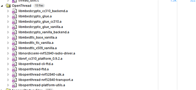

    The guidance you mentioned is too old for nRF5_SDK_for_Thread_and_Zigbee_v4.1.0. You can follow the following steps to disable the OT CLI library and use UART0 for your application:
    1. Delete "libopenthread-cli-ftd.a" and replace "libopenthread-nrf52840-transport.a" with "libopenthread-nrf52840-transport-none.a"
    2. Modify sdk_config.h to enable UART0, see the simple_coap_client_uart0 sample.

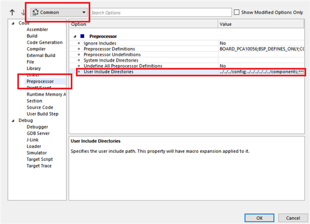

    4. Add header files path:
      Delete "UART_ENABLED=0" in Preprocessor Definitions, add more include directories to User Include Directories:
      ../../../../../../components/libraries/fifo
      ../../../../../../components/libraries/uart
      ../../../../../../integration/nrfx/legacy
      ../../../../../../modules/nrfx/drivers/include
