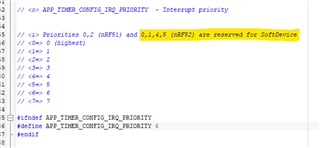

In this last case, I tried to change the IRQ priority reconfiguring APP_TIMER_CONFIG_IRQ_PRIORITY macro inside sdk_config.h header file
As on comment here below, I tried with priority level 2 or 3, but as sonn as the BLE connect, the FW goes into Hard Fault Handler

    Using the app_timer at priority level 2 or 3 can be risky, because you are not able to call any SoftDevice functions at these priorities. If you want to call a SoftDevice function, or any SDK function that calls the SoftDevice under the hood, you need to be at priority 6 or lower.
