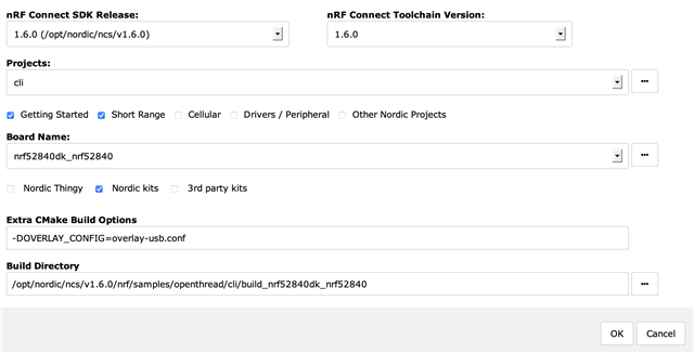

I am using the nRF 52840 development kit to explore Thread.  I am using the 'open nRF Connect SDK' command to get the project.  I would like to use the 'overlay-usb.conf' option so that I can access the cli via the USB connection using the 'serial' app on the mac.
I am running on  mac M1, Big Sur.
Segger 5.50c.
configure is as shown below.

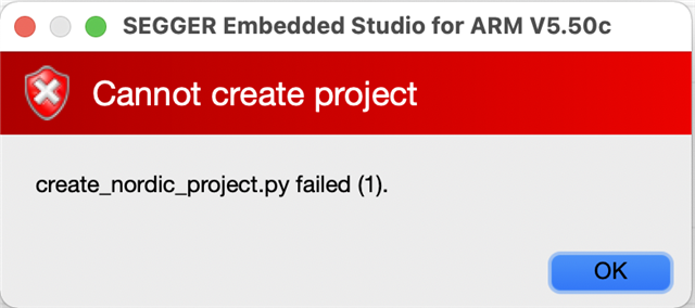

the creation fails with:
I clearly don't understand how to configure the overlay.

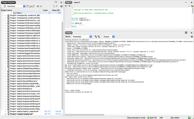

    Are you able to open the project without the overlay-usb.conf?
    Please provide the output message on SES after your press "OK" on the Cannot create project window.

    After pressing "OK" I get the screen:
    The output message indicates there is no overlay-usb.conf under the cli folder. You can download it from https://github.com/nrfconnect/sdk-nrf/blob/master/samples/openthread/cli/overlay-usb.conf and build again. It should fix the issue.
