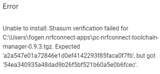

I was able to install all tools proposed by the nRF Connect v3.7.0 except the most important : Toolchain manager.
It retruns the following message
running Windows 10
What can I do? Integrity seems to be NOK?
Thanks.

Try to backup the folder .nrfconnect-apps, remove it from the home folder and try to install the toolchain manager again.
Please let me know this can help or not. Thanks.

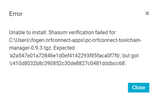

Hi Amanda,
thanks for your reply.
So I removed the .nrfconnect-apps, launched the nRF connect v3.7.0. All previous installed tools are no more installed. So I tried to install first the toolchain manager. It still fails with the following message.
Let me know what I should do as next.
best regards,
René
Hi Rene,
Could you check the network?
Download it in the browser https://developer.nordicsemi.com/.pc-tools/nrfconnect-apps/pc-nrfconnect-toolchain-manager-0.9.3.tgz

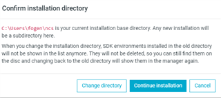

Ok, I'm a step further. I installed this package manually and after several trials it appeared in the nRF connect. Now, when
I try to install this, I got another problem. So, I click on continue installation and then it start the (apparently) the download jumps immediately to 50% and it stays there forever I have the impression.
Waht is now wrong here?

Hi Rene,
Could you remove the ncs folder and try again? Our expert feels there are some issues with your network connecting to our server.
