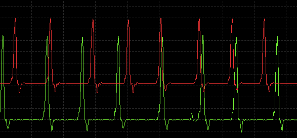

An update: I believe it is a scanning issue as the power consumption suggests the device is indeed transmitting. The green curve is ble_adv_extended_enabled set to 'false' and the red is 'true'. Spacing is ~28ms which is consistent with what nRF Connect reads. Not sure about the static offset though but that is a later concern.
