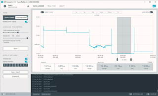

Looking at the product specification, the nRF5340 system off current is specified at 0.9 uA. Can you please provide an example that I can run on the DK which can help measure this? Do I need to put both cores in system off to achieve this current? Can you elaborate more on the Force-OFF mode?
Using the system off example from Zephyr with the nRF5340 with west build -b nrf5340dk_nrf5340_cpuapp, I was able to measure as low as 10 uA in the system off period using PPK-2 which is higher than 0.9 uA quoted in the product specification.
