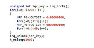

  • Hi,Torbjorn
    Thank you for your reply
    I have solved the problem of precise delay, but I have a new problem.
    I have a piece of code that doesn't need any external interrupts or events to interrupt, but I use the __disable_irq() function before that and then __enable_irq() function after that. But it did not achieve the desired effect. If I don't call __enable_irq() the effect of turning on interrupts is what I want
    1. Is there a problem with the __disable_irq() function? Why does closing interrupt and then opening interrupt affect the code in the middle? Is there any task or interrupt not closed successfully?
    2. Does my problem have something to do with the frequent switching of the interrupt switch? If so, how do I fix it?
    I am looking forward to your reply. This question is urgent
    Thank you very much

  • Hi
    Torbjørn
    Here's my code:
    Since I was using NCS 1.6.0, I replaced it with irq_lock(). Through the for (I = 0; i<200; I++) to flip the IO port, but the waveform seen with the oscilloscope is unstable. If only irq_lock() is executed and irq_unlock() is not executed, then the waveform is normal. The next two videos are my waveforms.
    May I ask what causes this? Looking forward to your reply
    Thank you very much
