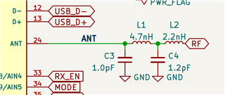

The nRF5340 has these components:

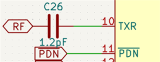

And the nRF21540 has this component:
I wonder if C3,C4,L1 and L2 are needed between these two IC.
Wouldn't be enough just used the C26?
I am using a single antenna.
The C28, C30 and L6 are needed to match the antenna impedance of 50Ohms, but I am not sure if it's actually needed to match impedance between ICs.

  • Hi Jose
    All the components shown on the nRF5233 and nRF21540 schematics are mandatory. Any antenna matching components comes in addition to L6, C28 and C30.

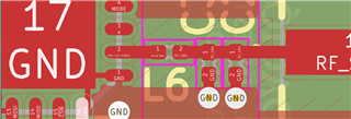

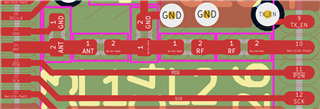

    I got another question regard to PCB board.

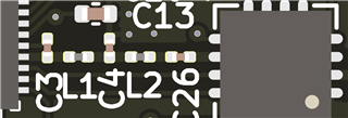

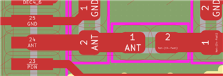

    I am placing all components as close as possible, including the SMA Connector like this:
    Between nRF52833 and nRF21540:
    3D View (Kicad Nightly)

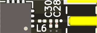

    And between nRF21540 and SMA Connector:
    3D View:

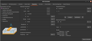

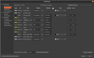

    The stack-up is this:
    And the width calculation for 50 Ohms is this:
    Is this components placement and distance correct or should I increase the distance between components?
    I am using the exact width of 0.355473 mm except between nRF52833 pin 24 (ANT) and C3 (The actual size is 0.3 mm)
    as far as I understand the width is ok for 50 Ohms but I have my doubts especially if there could be any problem between C3 and pin 24 of nRF53833.
    Any suggestion or recommendation?

  • You can do it like this, no problem. The lines are really too short to give you problems with the impedance. Just place the component as compact as you can and you'll fine.
