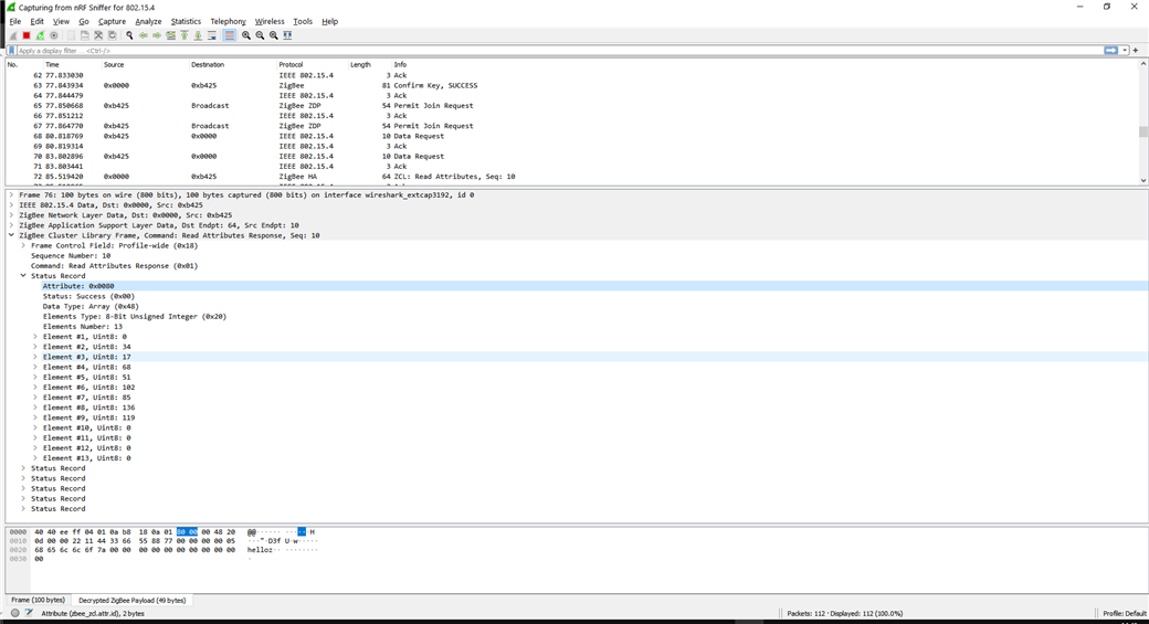

Hello!

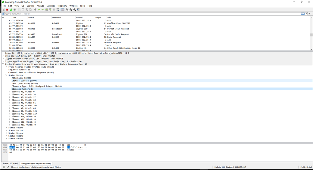

I add an attribute array (0x48) for the user cluster.
Having problems using the "array" attribute:
1. If you select the data type of 16 or 32 bits, then an alignment is added in the transmission, since the frame structure is: 8 bits for the type of array variables, then 16 bits for the length. Alignment is added after the 8 bit field for the variable type.
I use an array of 8-bit variables in the declaration, then a pointer to the desired structure and this is not a problem.
2. For some reason, 32 bytes are always transferred, regardless of the size of the specified array. Is this hardcoded or is it possible to specify the size?
