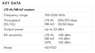

  • Does the nRF9160 support switching base stations on the move? Or can't it be switched and can only be reselected?
  • Kenny said:
    (DL/UL): 30/60 kbps ? Or (UL/DL): 30/60 kbps ?
     (DL/UL): 30/60 kbps, as per the product brief:
    Yes, this is handled by the nRF9160 modem and network.
    Øyvind
