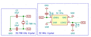

I created my first nRF52832 custom PCB board and I am having issues with poor RF performance. My project uses RSSI to estimate the distance between a peripheral and a central. My custom PCB for the peripheral works well. When using a BLE scanner on my phone, the peripheral can get up to around 30-40 ft away before my phone loses the signal. During this time the RSSI values go between -20 and -100.
However, when I use my custom board for the central, the peripheral can only go about 8ft away before losing connection and the RSSI values start at -55 and lose connection at around -80.
When using the central code on an nrf52 DK board this issue doesn't happen and the RSSI values/range are as expected which leads me to believe there is something wrong with my central board design.
Both the peripheral and central PCBs use the same antenna design/layout. The images presented below are the central PCB.
32.768 Hz (Y1): P/N -> Q13FC1350000400
32 kHz (Y2): Yangxing Tech X322532MOB4SI
I tried to keep the oscillators and the antenna components close to the chip.
This is a two-layer PCB where the fill for both sides is GND. I added an unconnected via near the antenna to create better grounding (not sure if that actually does much).
Any help would be greatly appreciated!
  • Originally I had the Rainsum AN9520-245 antenna connected on the L3/C12 node. I tested this for a peripheral however I didn't see a noticeable difference when the antenna was on the board vs when it was taken off so it ultimately got cut from the design.
    Does a central need a larger antenna than a peripheral as the peripheral uses the pictured design/layout and seems to work well?
    Will the Rainsum antenna work or is it better to have a PCB antenna like the DK?
    You need an antenna in your final design. The antenna also needs to be tuned to your PCB, this is not a straightforward task and requires some experience with RF and antenna design. Usually one use an external tuning house for this task.

     Both will work if tuned properly, but PCB antennas usually have better performance and is cheaper than a chip antenna. The disadvantage with a PCB antenna is the required space on the PCB versus a chip antenna.
