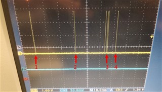

  • Hello , sorry for the delay. I was testing the chip a bit more. One thing I figured out was that the chip was not going to sleep as some log process was active. I disabled the log and now the chip consumes only around 16uA when advertising only.
    However, when the SPIS is on, it is consuming around 900uA. To see the SPIS duty cycle, I cleared a GPIO pin before __WFE() (line 46 in the code of the main post) and set a GPIO pin after WFE (line 48). You can see in the attached image that 1, 2, and 4 are prominent 'WFE on' peak that was initialized in every 32ms as I said earlier in the main post. However, in 3, there are some extra peaks that should not be there. Please keep in mind that in this code I combined the BLE UART example and SPIS peripheral example but no data was sent over BLE. Also, I disabled all UART and button functions to mitigate the possibility of pin leakage.
    Also, I included power management code in the SPIS peripheral example in the SDK and traced the WFE. There are no extra peaks between the prominent WFE peaks in 32ms. Also, the current consumption is around 480uA.
     So, I think the extra peaks (WFE on time) are responsible for the extra (900-480) or, 520uA current consumption. What steps should I take to debug those extra 'WFE on' peaks?

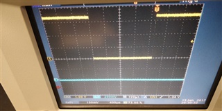

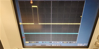

  • Thank you for your response. According to your recommendation, I have scoped the CS pin and confirmed that it is low (active) for 430us.
    Then I included the nrf_pwr_mgmt_run() function in the SPIS example (…\example\peripheral\spis) provided in the 17.0.2 SDK. Next, I confirmed that the SPIS is running properly by sending some known data.
    After that, I added a gpio_clear before WFE() and a gpio_set after WFE() to check WFE on time (code attached for reference). As you can see in the picture below, the WFE off time is only 8us.
    Also, I have tried,
    __SEV();
    __WFE();
    // Enter System ON sleep mode
    __WFE();
    However, current consumption was the same.
    Even without any BLE code, with nrf_pwr_mgmt_run() function active and 430us CS on time, the current consumption is still 480uA.
    According to this post, the EasyDMA draws 1.2mA, and according to Nordic Infocenter, the SPIS run current is 45 uA.
    So, even if we consider that EasyDMA is on for the whole CS active time, i.e., 430us, according to my calculation, the current consumption should be maximum of 45uA (SPIS) + (1.2mA * 430us) (EasyDMA) or 45.52uA.
