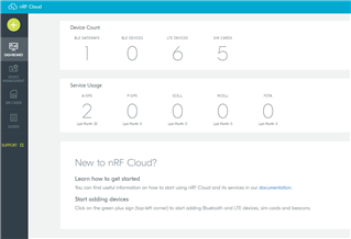

I'd like to add new device ( first one ) on Dashboard. According the manual I should press on green add sign, but there is no " + sign".

Hello Simon,
I've never seen that kind of issue before. Have you tried to refresh the page? This is what it should look like:

Thank You Øyvind for replay,
Yes I did! I was re_enter ( longing out and in ) several times in past two days.

Hi Simon, is your issue fixed?
SSimon said:Uncaught (in promise) InvalidSignatureException: Signature not yet current: 20210902T134316Z is still later than 20210902T134244Z (20210902T133744Z + 5 min.)
Our dev team informs me that AWS endpoints calculate a signature for authenticating request (they do not transmit the actual user secrets), and they are time based, to make these signed requests very short lived.
From the timestamps printed it looks like the users time is a little more than 5 minutes in the future.
The AWS Sig v4 algorithm however only allows for a maximum of 5 minutes: https://docs.aws.amazon.com/general/latest/gr/signing_aws_api_requests.html

Maybe I was too fast.
It is working from the first computer (Win7), but it is still not working from my laptop (Win10). Maybe the time delay is still too short?
If you are getting the same error, than it might still be too short. Please ensure that your clock is synced to a NTP server close to you.
Yes, You were right! My clock synchronization was disabled.Immediately when I synchronized the clock, I was able to login onto amazon cloud and consequently on nRF Cloud.
