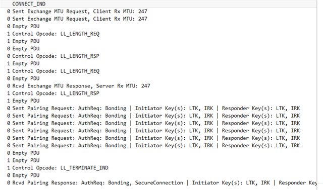

I am debugging connection of "Chromecast Remote Controller" with ble_app_interactive.
I am trying to implement ble_app_interactive on nrf52832 as my application.

I don't know why to disconnect after a few seconds .
Please help me about this issue.
I have attached a Wireshark file .

    The Central device  have been disconnected after sending  pair command in every times.
    Please explain whether I did correct procedure or not.
    or Could you suggest the other way ?
    The next image is ble packet image  after receiving CONNECT_IND  when to pair.
    I hope your life happy.
  • The error code is this.
    It seems to the peripheral device disconnects the link before the complete the pairing or encryption.
    According to your sniffer log the peripheral device sent a LL_TEMINATE_IND to central before sends a response for authreq.
    Can you check the code of Google RC that what things happened on it?
    and try to test with some parameter changes such as IO capabilities or clear with bonding information on both RC and DK.
