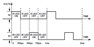

  • I am using ADPD4101 sensor which is from Analog devices. I was not talking about the color of the LED. Its about fast processing.
    I wish to switch RED and IR LEDs. I have sent you the while(1) block of code also.
    Max speed that we can set in controller side is of 400K right?? SPI cannot be used as I have only I2C provision
    RED on for 250 us (IR should be off) ----- complete off ----- IR on for 250us  (RED should be off) ----- Both off ------ should continue in the same way.
    Its not only switching but also I have to read the FIFO data from the sensor.
    Please have a look at the below model pic.
    I don't think that is possible with a 400k TWI bus.
    I suggest you scope the TWI bus and LEDs with a logical analyzer and verify what timings you are actually getting.
