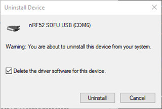

The Dongle was given to me by a colleague of mine who has the exact same laptop as I do. The Dongle was and is working fine with his laptop. The problem is with my office laptop. I can not try any of the App in nRF Connect.
I tried on an other personal laptop and it is working.
I tried many things but never got it to work.
Uninstall and reinstall nRF Connect 3.7.0
Uninstall and reinstall nRF Connect 3.6.1 (previous version, same as my colleague)
In one support thread, Jorgen suggest to reinstall nRF Connect, which solve the problem for someone.
https://devzone.nordicsemi.com/f/nordic-q-a/59926/nrf52840-dongle-installation---win10---libusb-error
It didn't worked for me. Driver was correctly installed during the reinstallation.
Then I tried to install the USB CDC ACM driver using: nrfconnect_cdc_acm.inf from Github. Didn't helped.
I am having all sorts of problem since the beginning
right now I have: Error while setting up device EA4A9FE62ECB: Missing serial port (while trying to run the RSSI App)
I had, previously LIBUSB error
I also had, previously a timeout while programming. Dongle was in DFU mode begin programation, red LED flashed a few times and then timeout.
Is there any known problem with Windows 10.
