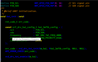

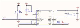

[nRF52805] ble app uart + I2C + LIS3DH Acc Output X,Y,Z values from LIS3DH 0!!!
values returned by ACC is always 0  !!
shema hardware LIS3DH :
shema hardware NRF52805 && LIS3DH :
twi initi:
#define PIN_SCL             NRF_GPIO_PIN_MAP(0, 16) // SCL signal pin
#define PIN_SDA             NRF_GPIO_PIN_MAP(0, 18) // SDA signal pin
I was based on this link NRF52840:
iamjustinwang.blogspot.com/.../nrf52840-ble-app-uart-i2c-lis3dh-acc.html
Please help me to fix this. Also, If you think any other approach is simple and efficient, please let me know. Im open to suggestions.
     * @brief UART initialization.
    void twi_init (void)
        ret_code_t err_code;
        const nrf_drv_twi_config_t twi_lm75b_config = {
           .scl                = PIN_SCL,
           .sda                = PIN_SDA,
           .frequency          = NRF_DRV_TWI_FREQ_400K,
           .interrupt_priority = APP_IRQ_PRIORITY_HIGH,
           .clear_bus_init     = false
        err_code = nrf_drv_twi_init(&m_twi, &twi_lm75b_config, NULL, NULL);
        nrf_drv_twi_enable(&m_twi);

            #elif (Sensor_Select == LIS3DH)
                snprintf(printf_buffer, 20, "No-Support");  //LIS3DH no Gyro sensor
        else
            #if (Sensor_Select == MPU6050)
                snprintf(printf_buffer, 20, "A: %.1f; %.1f; %.1f", MPU6050_Acc[0], MPU6050_Acc[1], MPU6050_Acc[2]);
                snprintf(printf_buffer, 20, "A: %.1f; %.1f; %.1f", LIS3DH_Acc[0], LIS3DH_Acc[1], LIS3DH_Acc[2]);
                printf( "A: %.1f; %.1f; %.1f \n", LIS3DH_Acc[0], LIS3DH_Acc[1], LIS3DH_Acc[2]);
        length = strlen(printf_buffer);
        uint32_t err_code = ble_nus_data_send(&m_nus, (uint8_t *)printf_buffer, &length, m_conn_handle);
    void sensor_raw_data_get(void)
            MPU6050_GetAccData(MPU6050_Acc);
            nrf_delay_ms(50);
            MPU6050_GetGyroData(MPU6050_Gyro);
            LIS3DH_GetAccData(LIS3DH_Acc);
    void sensor_init(void)
            MPU6050_Init();     //MPU6050 Sensor Init
            LIS3DH_Init();      //LIS3DH Sensor Init
        bool erase_bonds;
        // Initialize.
        uart_init();
        log_init();
        timers_init();
        power_management_init();
        ble_stack_init();
        gap_params_init();
        gatt_init();
        services_init();
        advertising_init();
        conn_params_init();
        twi_init();             //I2C Init
        nrf_delay_ms(50);
        sensor_init();          //Sensor Init
        nrf_delay_ms(50);
        // Start execution.
        printf("\r\nUART started.\r\n");
        //NRF_LOG_INFO("Debug logging for UART over RTT started.");
        advertising_start();
        StringSelect = Output_Select_Acc;
        length = Default_Zero;
        // Enter main loop.
        for (;;)
            sensor_raw_data_get();      //get sensor raw data via I2C
            nrf_delay_ms(500);
            sensor_raw_data_output();   //output sensor raw data via BLE-UART
            idle_state_handle();
        // Enter main loop.
        /*for (;;)
    please help me i just need some configuration in Lis3dh.c
  • Hi
    Is the device running as intended in the other regards than the TWI returning invalid/wrong values? What SoftDevice are you using in this application?
    Seeing as the values are all 0, do you move the device at all? I would imagine an accelerometer would only output values other than 0 if in motion. Are you able to confirm which line is printing these values exactly? I didn't spot what could be wrong at the first glance at your code I'm afraid.
    SImon
