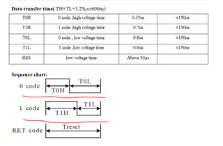

    I'm not that familiar with the WS2812 but I found some timing requirements from the document here: https://cdn-shop.adafruit.com/datasheets/WS2812.pdf. Are these correct for your device? If so, are you able to tell from the scope trace how much off you are for '1' and '0' with the default configuration?

  • I was able to identify a solution by slightly modifying the driver code to accommodate my inverting driver. You'll notice in the .overlay file that comes with the sample code has the ONE_FRAME value defined as 0x70 and the ZERO_FRAME defined as 0x40 and a clock speed of 4MHz (each bit becomes 250ns). So the following is true for the non-inverting, standard driver:
    spi-zero-frame =
    0x40 =
    0100000 =
    250ns pulse ON & 1050ns pulse OFF
    spi-one-frame =
    0x70 =
    01110000 =
    750ns pulse ON & 900ns pulse OFF
    Reset signal (0) of 8us.
    Now, to change this code for the inverting logic level shifter we can observe the following changes:
    spi-zero-frame =
    0xBF =
    10111111 =
    250ns pulse OFF & 1050ns pulse ON
    spi-one-frame =
    0x8F =
    10001111 =
    750ns pulse OFF & 900ns pulse ON
    Reset signal (1) of 8us
    The reset signal becomes a little tricky in the inverting world. I was able to achieve this by filling a buffer length of 5 with 0xFF. This is because with our  clock frequency of 4MHz, 1 bit = 250us, so 5 * 8 bits * 250ns = 10us.

  • Thank you for posting the solution here! It looks like you found a good way to generate the reset signal. But are you sure 10 uS will be sufficient? I noticed it said >50uS in the datasheet I found.
  • The original `ws2812_reset_delay(); ` function call in the driver delayed for 8us. Since we've validated previous hardware revisions with the stock driver, I tried to recreate its functionality as close as possible. I'll keep an eye on it and know what to tweak if something doesn't look right.
