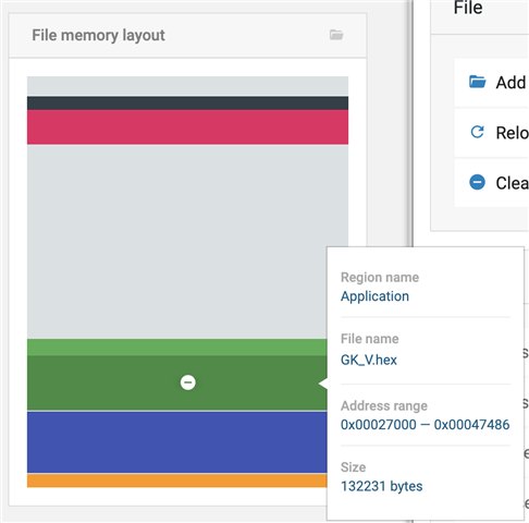

    Here's the memory map according to the nRF Connect, which recognises the application start at 0x27000.

  • Hi Amanda,
    Just confirmed that it works with mergehex version 10.14.0, both on Windows 7 and Mac (Catalina), for both s140_nrf52_7.2.0 and 7.3.0 softdevices. So I guess the issue is linked with mergehex 10.13.0 or lower and s140_nrf52_7.2.0_softdevice +.
