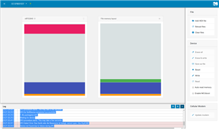

I have a nRF52840 and am unable to flash an application to it. I am trying to flash the "examples/ble_peripheral/ble_app_blinky/hex/ble_app_blinky_pca10059_s140.hex" file of the nRF5 SDK 17.0.2, after trying to flash various other applications. Strangely it is possible to flash the device using applications without a soft device like the nRF BLE Sniffer file sniffer_nrf52840dongle_nrf52840_4.0.0.hex.
The os is an openSUSE Leap 15.2 linux with a 5.3.18-lp152.87-default kernel.
On top if trying to flash "ble_app_blinky_pca10059_s140.hex" after the Error it shows the SoftDevice Section as required (see screenshot), even if there was a application without SoftDevice present on the device. So it seems like at least a part get flashed as requested.
Is there any suggestion where I would be able to continue looking for the error?
Below is the log and a screenshot of the programmer after the error occured.
Kind regards and thanks.
The relevant log:

A Screenshot
    The examples/ble_peripheral/ble_app_blinky/hex/ble_app_blinky_pca10059_s140.hex combines with Softdevice as the log indicates SoftDevice detected, id 0x103 (S112 v7.2.0)
    The device will reset when the upgrade completes and the dongle will no longer show up in nRF Connect unless the application used DFU Trigger Library is used, as it is no longer in DFU mode. You will get an error stating "Reopen device failed" in this case, and have to push the RESET button in order to make it show up in nRF Connect Programmer again.
    You can use nRF Connect mobile app to check the device advertise "Nordic_Blinky" or not.

     Thank you very much for the answer, it gave me the necessary hint: The device resets itself 2 time, once after the softdevice flash and once after the flash of the application.
    For anyone who has a similar error:
    The error was that the reset of the device after the flush of the softdevice triggered a third application (in my case ModemManager) to open the serial device-file /dev/ttyACM0 and block it for a few seconds. During that time the device was busy, so nRF Connect was unable to open it to flash the application to the device, resulting in the error message given above.
    How to check for this and how to find out which application is blocking nRF Connect from opening the serial device:
