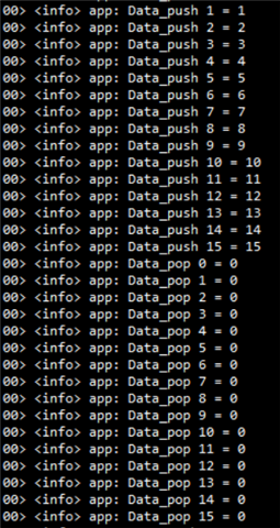

  • I tried to push and pop some data but it didn't work. When I pop data and read the buffer I read just zeros..
    int16_t records_push[16];
    int16_t records_pop[16];
    int16_t received_data[16];
    NRF_QUEUE_DEF(int16_t, m_sensor_data_queue, 200, NRF_QUEUE_MODE_OVERFLOW); // define a queue instance
    uint8_t records_size = sizeof(records_push) / sizeof(records_push[0]);
    void my_sensors_buffer() {
    //Populate the buffer
      ret_code_t err_code;
      for (uint8_t i = 0; i < records_size; i++) {
        records_push[i] = i;
      err_code = nrf_queue_push(&m_sensor_data_queue, records_push); // queue the buffer
      err_code = nrf_queue_pop(&m_sensor_data_queue, records_pop);
      //memcpy(received_data, records_pop, records_size);
        NRF_LOG_INFO("Data_pop %d = %d",i, records_pop[i]);
    What you actually push and pop is one element; the first value in the arrays, which has the value 0.

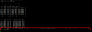

    3. I use the NRF_QUEUE_MODE_OVERFLOW mode. When the buffer is getting full, I expect to start overwriting starting from the 1st element of the queue. However, this does not happen. If I reduce the QUEUE_SIZE to 19 (instead of 20), maintaining the same payload, I got the error NRF_ERROR_NOT_FOUND
