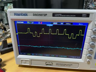

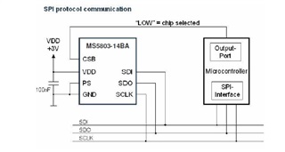

I'm trying to get data from a pressure sensor.
But it seems that BLE device is not properly got data from the sensor.
Here is a data sheet of the sensor. (Please see page 15 how I made a custom board for the sensor and how I wired.)
I'm developing with my custom boards.(Boss of nRF52832 and the sensor.)
My code is below.

  • To read data from a sensor you need to use SPI master (SPIM), the sensor will be the SPI slave (SPIS).
    Kenneth
    Thanks for your reply and advice!!!
    I got it!!
    Then, I noticed that I have made a program via SPIM, not SPIS.
    (I thought that I made a program with SPIS...)
    Maybe, my wire connection was wrong...
    I will let you know how it works.
    Kindly Regards,
    Shigeto
    I noticed that my pin assigns ware wrong. So does wire connections between BLE and sensor.
     I fixed them and debugged the program.
    However, both m_rx_buf_rd and m_rx_buf_rs got just null...
    Does it mean that the sensor detect zero pressure on?? Or something's still wrong?
    If something's wrong, would you let me know knacks to solve this kind of problem, please?
    BTW, Below is slightly amended code.

  • You need some way of finding out what is sent on the SPI interface. Do you by any chance have access to a logic analyzer or oscilloscope so you may observe the SPI pins? Alternatively can you connect MOSI to MISO, and check that data sent in tx_buf is received on rx_buf after transfer is finished?
    Kenneth
    Well, I actually tested that whether there is some output signal or not.
    Of course, MOSI is sending some signals.
    Below is the pic of my oscilloscope.(Yellow is MOSI. Blue is MISO.)
    However, MISO can not receive the signal from MOSI.
    (I directly connected MISO and MOSI, though... Also, I connected an 1k resistor between MISO and MOSI...)
    Does anyone has ideas?
    Kindly Regards,
    Shigeto
