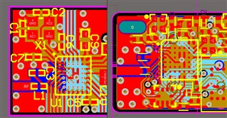

I had to make a tiny, 4 layer PCB based on an nRF52832 chip (WLCSP) and I've chosen to use a PCB antenna.

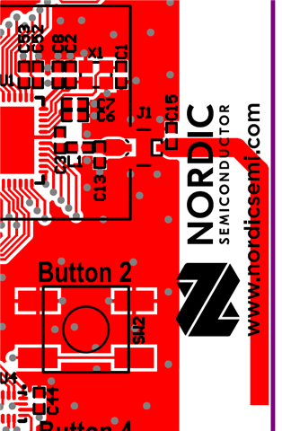

I've copied the reference design (nRF52832-CIAA Reference Layout 1_0) as much as possible to reach a good RF performance, but that didn't end up happening, as I'm seeing the max BT range about 1meter. Can you help me point out where I was wrong?
The dimensions are similar between the reference board (11.44 x 9.56mm) on the left and my pcb (14.1 x 8.2mm) on the right of this picture:
My design compared to the reference:
  1. Antenna width, high and position in relation to the chip is the same
  2. L1 & C3 are the same value (3.3nH, 1pF, same position, but smaller footprint (0201)
  3. Lots of GND area and vias around the antenna (inner layers are also GNDs with keepout zones around the antenna)
  4. Antenna is further away from the board edge because of manufacturing limitations (0.279mm vs 0.409mm)

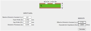

  5. I've checked several online calculators to get as close to 50Ω as possible. The parameters that I've used:
    1. 4 layer FR4, dielectric constant of 4.2 (provided by the manufacturer)
    2. 0.676mm thickness between the outer copper layers (provided by the manufacturer)
    3. The suggested gap ended up being 0.137mm
https://chemandy.com/calculators/coplanar-waveguide-with-ground-calculator.htm
