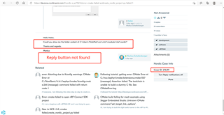

Sorry,I can't find the reply button,The folder content of C:\Users\ThinkPad\ncs\v1.6.1\modules\hal\nordic is empty.
Referring to case #276491
Hello Helen,
My apologies for that.
Well, that explains the error you are facing. Could you please open a bash terminal, as shown in the picture below?
In the command line, please type:
$ west update
Could you provide me with the log after you have done that?
Thanks and regards,
Markus

Hello Achim,
Achim Kraus said:Is there a trick?
cases can not be answered any more if their status is “Verified answer” or “Closed”. Otherwise, you should be able to answer.
Please raise a ticket with reference to the actual case if you experience this again. We might want to report it to our DevZone development team.
