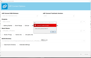

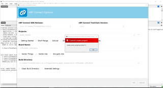

error: cmake failed andcreate_nordic_project.py failed (1)
Excuse me
                    I install nrf connect SDK(v1.6.1) by Toolchain Manager,An error occurred when I imported a project into SES.I can't find the reason?
Creating solution asset_tracker.emProject

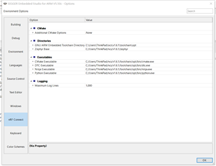

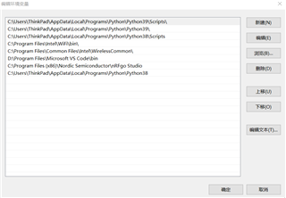

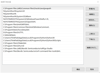

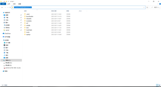

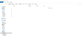

I try to make the configuration shown in the figure below, but it can't solve the problem.
