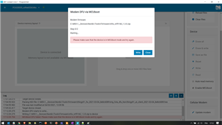

I have never managed to successfully upgrade the firmware of my nRF9160 Thingy:91.
I am using the nRF Connect v3.7.1 with the Programmer tool.
I have followed the documentation and tried the SW3 Button + Power Button + Add Hex File method. I have tried the SW4 Button + Power Button + Zip file method
But the upgrade never goes through and I often end up with a message such as "Please make sure that the device is in MCUboot and try again" (depending on the method choosen).

    When I first opened this thread, I had been using thingy91_fw_2021-03-04_8e8c6089.zip and mfw_nrf9160_1.3.0.zip

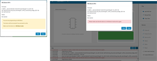

    I have retried this past week with the latest thingy91_fw_2021-06-28_7a076c22.zip, trying to flash img_fota_dfu_hex\thingy91_nrf52_connectivity_bridge_2021-06-28_7a076c22.hex using the SW4 + Power Button. But each time I try to write the .hex file onto the modem I get the same error :
    Then the device restarts in normal mode.
    Are there some other pre-requisite to flashing that I am missing ?
    The SWD Selection switch (SW2) is set to nRF91, which I believe is the default/correct one for this.
