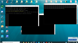

peripheral_uart, how to separate console and communication ?
I work with win10 laptop, Toolchain  nrf Connect SDK 1.6.1 on a nrf5340dk.
I like to use the uart1 for the console (printk debugging) and the uart0 for communication.
In prj.conf I add "CONFIG_NRFX_UARTE1=y".
And in nrf5340_cpuapp_common.dts (in board folder) I change uart0 by uart1
" chosen {
        zephyr,console = &uart1;   //&uart0;
        zephyr,shell-uart = &uart0;
        zephyr,uart-mcumgr = &uart0;
        zephyr,bt-mon-uart = &uart0;
        zephyr,bt-c2h-uart = &uart0;
But  nothing works, Leds are not blinking no more,
I can not see anymore the bluetooth module on the App nRF Connect,
and nothing on the serial terminal.
Could you help me please ?
Best Regards,
Rob.
    In most cases I recommend using an overlay file instead of editing the board files.
    In the overlay file you should set the console to uart1, enable uart1, reconfigure the uart1 pins, and disable i2c1 as it conflicts with uart1:
        chosen {
    &uart1 {
        status = "okay";
        tx-pin = <35>;
    	rx-pin = <34>;
    &i2c1 {
    	status = "disabled";
    The default uart1 pins can not be used, as they are by default used by the network core.

    Thank you for your answer.
    I try to make the modification on the prj.overlay file:
    8765.prj.overlay
    I add CONFIG_NRFX_UARTE1=y in the prj.conf file:
    8863.prj.conf
    and in the main.c file I make a function to use the uart:

    I would like to send to the uart "01234" and send to the uart1 the printk "service",
    but I send on the uart 0 "service" and "01234".
    What should be done to separate sending of the Tx on uart0 and the printk on uart1 ?
    Best Regards,
    Rob
  • Call the overlay file nrf5340dk_nrf5340_cpuapp.overlay, not prj.overlay.
    Let me know how that changes the behavior.
    You can also try changing the log configs at the bottom of your prj.conf:
    CONFIG_USE_SEGGER_RTT=n
    CONFIG_LOG_BACKEND_RTT=n
    CONFIG_LOG_BACKEND_UART=y
  • Thank you !
    Now it's work, but I can read an error:
    <wrn> bt_ecc: ECC HCI commands not available
  • You can ignore that warning, that is as expected.
