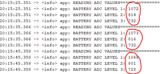

I am using multiple ADC pins and realized that repeated calls to the ADC give inconsistent data, suggesting that the conversions are not completing before the next call. I am using the blocking function nrf_drv_saadc_sample_convert(pin, &value), so I assumed it would complete before allowing me to call again but that seems to be false. To check, I artificially call nrf_drv_saadc_sample_convert multiple times and print to UART; however, I need to wait a whole 1000 msec before the next call is consistent to the previous one!

For testing purposes, I have a single ADC pin read 3 times in my battery_read() function, which iterates every 10 seconds.
static void battery_read(void)
    nrf_saadc_value_t adc_result;
    uint32_t battery_level_millivolts;
    NRF_LOG_INFO("READING ADC VALUES===============");
    nrf_drv_saadc_sample_convert(NRF_SAADC_INPUT_AIN7, &adc_result);
    NRF_LOG_INFO("BATTERY ADC LEVEL 1: %d", adc_result);
    nrf_delay_ms(10); // artificial delay
    NRF_LOG_INFO("BATTERY ADC LEVEL 2: %d", adc_result);
    NRF_LOG_INFO("BATTERY ADC LEVEL 3: %d", adc_result);
Even at 10 msec delay between nrf_drv_saadc_sample_convert() calls, the UART output gives decreasing ADC values. I have to make the delay closer to 1000 msec to get consistent data (which is way too slow)

  • Sounds to me that you are measuring a very high impedance source (e.g. >1Mohm), which each time the pin is sampled need to be "charged" before it return to the same level. Can you connect a small capacitor (e.g. >1nF) on the analog input to see if this affect your results?
