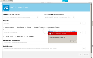

    In further experimentation I find that this build error is actually occurring in every nRF sample Zephyr based app from nrf SDK version 1.6.1.  This error is reproducible, when opening Segger SES 5.60, and selecting "File > Open nRF SDK Connect Project...".
    The one Devzone ticket I could find involving this error is from 2018.  The circumstances described in that ticket don't appear to closely match my situation, but per that post I have tried switching released version of nrf SDK.  When pointing Segger to nrf SDK 1.5.1 the project fails to create due to an error encountered by a called Python script `create_nordic_project.py`.  There's no specific fault or error message given.  I reach the same project creation failure when trying nrf SDK 1.7.0 and 1.7.0-rc2:

  • Good morning Simon,
    Regarding my post on "offsets.c.obj does not exist" build error, I have found a solution though not a detailed explanation.  Please do not take any new time looking into this matter.
    On a careful review of my toolchain settings I found that I had Segger calling `crosstool-NG 10.2.0` instead of the latest stable GNU ARM cross-compiler, available at [GNU ARM downloads page](https://developer.arm.com/tools-and-software/open-source-software/developer-tools/gnu-toolchain/gnu-rm/downloads).
    Here is a tabular summary of compilers and build success/failure project conditions:
                                               command line and `west`     Segger Nordic v5.60
    arm-zephyr-eabi-gcc (crosstool-NG) 10.2.0           yes                         no
    arm-none-eabi-gcc (GNU Arm) 10.3.1                  yes                        yes
    I apologize for the mistake and for wasting your time. I still suspect that the root cause may be in the manner that
    `create_nordic_project.py` captures project settings upon first opening an nRF Connect SDK application. This so because
    both compilers succeed in building working projects when called via `west` at the command line.
