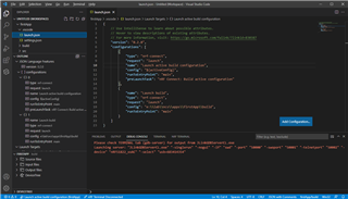

Hi Nordic
   After fellow your youtube tutorials, blinky sample can be built successfully. Flashing code to PCA10090 DK,
the LED started blinky well.
   However, it failed to enter debug mode. Please see attached picture. Something wrong?

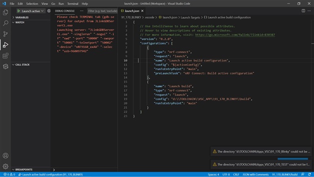

    Could you verify your path for the 'launch.json'? It might be because the VS Code is unable to find the executables required to launch the debugger. The executables should be in the same folder as the toolchain path.

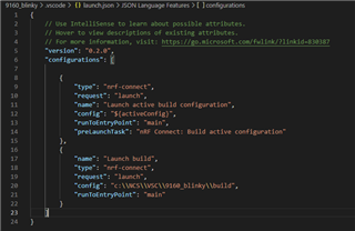

  • Hi Priyanka
    I am new user for vsc and have no idea how to verify the path for the "launch.json".
    I followed every steps at the youtube tutorials. At youtube demo, I saw it was very easy to enter debug mode.
    After error window popped up, I click "open launch.json" button. It showed below.
    I will share my launch.json here.
    As you can see, in the second configuration, I have
    "config": "c:\\NCS\\VSC\\9160_blinky\\build"
    First, you need to identify your default directory for nRF Connect Toolchain. Mine is  c:\\NCS
    You can do this by opening nRF Connect for desktop --> select Toolchain manager --> select settings. Here the directory can be seen.
    Next, try building the application or samples using VSC within this path. I created a folder VSC within the NCS folder : c:\\NCS\\VSC
    This can be done when specifying the Application location before you create a new application.
    I guess this might have caused the error. nRF Connect with VSC is quite new and I too am just in the beginning steps. Kindly try changing the directory this way and let me know how it goes.

  • Hi, PK,
    I still have this issue even follow your steps. My steps are follows:
    1. check my default directory of nRF Connect Toolchain, which is E:\lab\ncs
    2. create my app under this folder
    3. After I build my firsetApp, I clicked debug. Then a window as below popped up:
    4. Then I clicked the "Open 'launch.json' button. It said the file is not found, and let me choose which folder to add this file to. I selected firstApp folder. Then it asked me which environment I should use. And I chose nRF Connect. After this, the launch.json is created under this folder:
    5. After this, I clicked the debug again. the above error window still popped up.
    Any idea?
