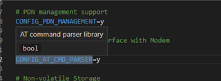

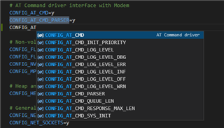

    You can include the library simply by adding CONFIG_AT_CMD_PARSER=y to the prj.conf file in your project directory. This will make the CmakeList file in \nrf\lib include the at_cmd_parser folder:
    Tip: we recently launched our VS code extension for the nRF connect SDK which supports auto-completion and jump to definition for kconfig symbols. It's very convenient when you try to navigate through the various configuration settings.
    Vidar
