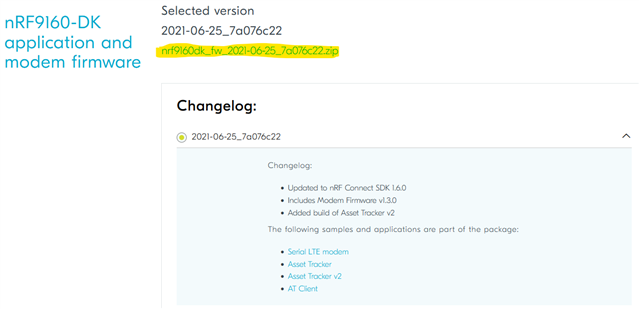

    The serial_lte_modem is available as a compiled hex for the nRF9160 DK(recommended starting point) as well as for Thingy:91(prototyping platform). If you are using custom HW you need to compile your own hex(this also applies if you are using a third party module which is different from the DK or Thingy:91).
    Please navigate to the respective downloads page for either the DK or Thingy:91. Select the version of choice and click the blue link(highlighted in yellow).
    The .zip contains multiple hex files. The CONTENTS.txt file will help you select the correct hex, for example "img_fota_dfu_hex/serial_lte_modem_2021-06-25_7a076c22.hex". This hex is compiled using nRF Connect SDK v1.6.0.
