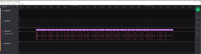

    Here is the expected waveform from my test (just a sequence of characters) when:
    current-speed = <9600>;
    is in the board's .dts file

    By zooming in appropriately and lining up the two waveforms, it appears that the 115200 baud version doesn't start properly.    Could this be a problem with the UART or the clock?   After the first couple of characters, the waves track each other pretty closely, but since everything gets shifted the decoding fails.   Here is the beginning of the two waves, zoomed and lined up:
    Still trying to figure out what is happening...
    Thanks!
    As the waveform has jittering, the parser is parsing at the incorrect edge.
    Q1: is this scope taken from reset state?
    Q2: Do you see the same issue if you connect a receiver on the other end?
    Håkon

    Q1 answer: Yes.  I start the logic analyzer capture, then start the code, capturing the entire sequence, then stop the logic analyzer and zoom into the UART transaction.   This is the first (only) transaction.   I substituted the normal control sequence that should be sent for a simple letter sequence to help see the results on the logic analyzer.
    Q2 answer: There is a receiver attached.  The UART is connected to a Sierra Wireless XA1110 GPS module.   The module is delivered preconfigured to run at 115200 baud, so communication must be at that speed to configure anything (including changing the baud rate).  The two connections (TX_UART and RX_UART) are point-to-point and shown in the following images.   They are both only about 35 mm in length.   (The rectangular pads near the center of the trace are for clip points to attach the logic analyzer.)  I thought that perhaps this was a "transmission line" issue, but if that was the case, I would expect all edges to be affected, not just the ones in the first couple of characters.   Here are highlights of the two nets:

    Jitters during, and straight after reset is to be expected, as the line is undefined prior to the firmware setting it. You can add a pull-up resistor on the line if you'd like.

    As you mention, if the issue is only in the startup sequence, the issue is not purely electrical in the sense that capacitance etc. is causing this. I believe it is related to the GPIO state when the nRF is in reset and starting up. Could you try to add a pull-up resistor on the line to see if this helps?
