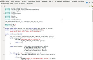

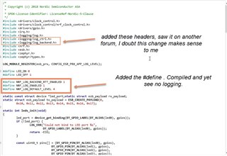

    Thank you for your prompt reply. Where exactly are they to be enabled? Are these #defines that I need to add in the main.c file? I did that and it still does not work.
    Are there header files I need to add to the sample code to enable logging? Are there other files I need to add to the project that needs to be compiled and  linked? This update of adding #defines seems insufficient.

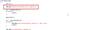

    To move forwards my first step is to 1st enable logging.  I want to see "Enhanced ShockBurst prx sample" logged on the console as soon as the program starts. This logging info is provided by the sdk itself. Just not sure how to make it work. Please help what other change are needed to get this working..

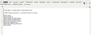

    I just tried your suggestion. I still cannot seem to get it working. Sorry about that. What am i missing. This is the change to the prj.conf file.
    After making the changes, I imported the project once again to segger embedded studio.
    The main.c file is as per the 1.7.1 sdk. I removed the #defines previously stated in this thread. (Even with adding those #defines it does not log)
    Compiled the file and have downloaded it to nrf5340-DK. Disconnected the RTT viewer and enabled it again. Pressed the reset button to restart the code.
    I do not see any logging.
    The problem with this is that a pinreset will cause the debugger to loose connection with your device so you will have to manually re-connect afterwards. UART is better in that regard. You also need to remove the CONFIG_NCS_SAMPLES_DEFAULTS setting as it selects CONFIG_LOG_MINIMAL that doesn't support the RTT backend.

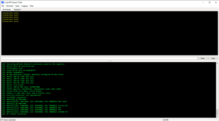

    After the program is downloaded successfully, it says:
    Illegal value 0x21001450 written to register 66 (MSP_NS) ignored
    Is this something got to do with why the program/ console logs are not working?
    Yes, I added the for loop to print a msg. I still see nothing. I removed CONFIG_NCS_SAMPLES_DEFAULTS as well, and no logs seem to appear.

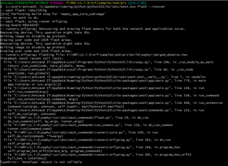

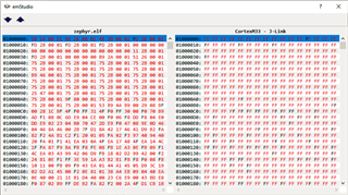

  • I have tried to verify the code.
    It appears nothing is downloaded to the the network core's flash. Is the core locked? How do I unlock it? When I compile and download It keeps saying successfully  downloaded, not sure what is it successfully downloading if the verification fails.
    Any comment on what all this is? I literally just need a console log out put. Seems like there are other issues that need to be addressed here :( .

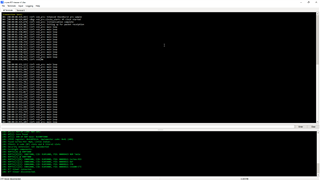

  • I see the same now when I try to use Segger Embedded Studio and I need more time to investigate. Are you able to work with the VS code extension or from the command line in the meantime?
    Building from the command line:
    // Update PATH to include the SDK build tools
    c:\Users\<user>\ncs\v1.7.0>toolchain\cmd\env.cmd
    // Change directory to sample folder
    c:\Users\<user>\ncs\v1.7.0>cd nrf\samples\esb\prx
    // Build command. Includes "empty app core" as a child image
    c:\Users\<user>\ncs\v1.7.0\nrf\samples\esb\prx>west build -b nrf5340dk_nrf5340_cpunet -- -DCONFIG_NCS_SAMPLE_EMPTY_APP_CORE_CHILD_IMAGE=y
    // Run recovery procedure, then flash both cores
    c:\Users\<user>\ncs\v1.7.0\nrf\samples\esb\prx>west flash --recover
