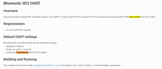

    UART pins in nrf52840 are rx-8 tx- 6, no HW flow control.
    what changes I need to for above UART configuration in nrf connect sdk zephyr side?
    HW flow control pins are not connected (between MCU & nrf52840 chip).
    But here I see HW flow control is required
    Give me some steps , how I can proceed here?
    Are you testing with your custom WH or a DK? Assuming a DK, you can see that there are overlay files for the various DKs under zephyr\samples\bluetooth\hci_uart\boards\. If you are using the nRF52840 DK the nrf52840dk_nrf52840.overlay is what is relevant for you. There you can see a line with hw-flow-control. To disable flow control, remove this line.
    Note that if using a custom WH you should consider (at least at some point) making a separate board configuration for it where you specify everything instead of using an overlay to specify the differences of your board vs a DK.
    Lastly, in general using UART whiteout flow control in case where you cannot easily handle loss of data using flow control is almost required. So for instance for logs skipping flow control is OK. In this case, I would suggest you consider if it is really wise to skip flow control.
