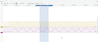

I've tried to toggle test GPIO pin state in GPIOTE event handler callback for debugging, and it appears it is triggered on every 5-10 input pulses instead of every rising edge as expected. It could mean GPIO events or interrupts have unexpectedly big latency.
I tried to avoid using any additional peripherials and poll the clock pin in a loop, and the best result I was able to achieve is that output debug pin is toggled on every 3 incoming pulses. That means NRF52 takes too long to read changed GPIO pin state, unexpectedly long for CPU running at 64MHz and peripherial clocks at 16 or 32 MHz

Channel1 -- input clock, Channel2 -- output debug pin
Even just changing the state of output debug pin results in only ~3.1MHz output

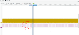

    Here is the complete minimal compilable example that demonstrates the problem.
    There is an input 4MHz clock on clock pin 3, and output test signal is generated on pin 19. Both are recorded by oscilloscope.  Output pin is toggled in timer compare event.
    Is everything in this code ok?

    Issue that I see here that output pulse period is not fixed and variates.
    If there is an input 4MHz clock, and timer compare value is set to 372,
    I expect output pulse width (time between two compare events) to be
    1/4000000*372 = 93 us, but shortest pulses visible on a picture are about 45us each,
    i.e compare event happens 2x more times than expected?

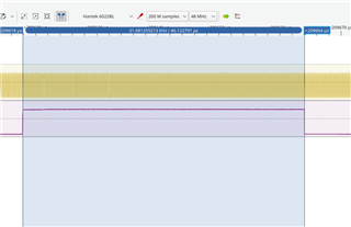

  • * Lower the input frequency (let's say 2 MHz) to see how it behaves then?
    I used test signal from oscilloscope, it has 2KHz pulses,
    and at this frequency output pulse width is usually
    correct (i.e. if I count input pulses, they match timer compare value),
    but sometimes there are still shorter intervals between timer compare events
