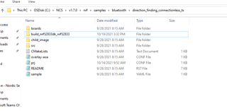

  • Can you please clarify where these build folders should be and which directories I should run the west command from? I have been using SES to build everything so I am not sure where these build folders should be. I do not see them in the direction_finding_connectionless_tx folder

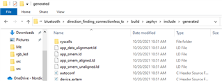

    1. Now you might see a folder as shown below called 'build' or 'build_nrf52833dk_nrf52833' or something similar. First, manually delete this folder from here.
    If there is no such folder then good, let's begin with the next step.

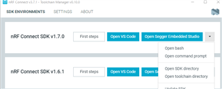

    2. Next, Set the CONFIG_BT_DEVICE_NAME to "DF Connectionless Beacon App 1" and then, go to the nRF Connect -> Toolchain Manager and choose 'Open Command Prompt'
    3. This opens west and you can navigate to you folder location to where the direction_finding_connectionless_tx is, for eg, I used '' cd C:\NCS\v1.7.0\nrf\samples\bluetooth\direction_finding_connectionless_tx'' command since this is my path.
