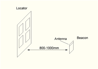

I developed a locator and beacon pcb boards for AoA direction finding using the NRF52811 chip. The locator has 4 patch antennas and the SKY13575-639LF external antenna switch.

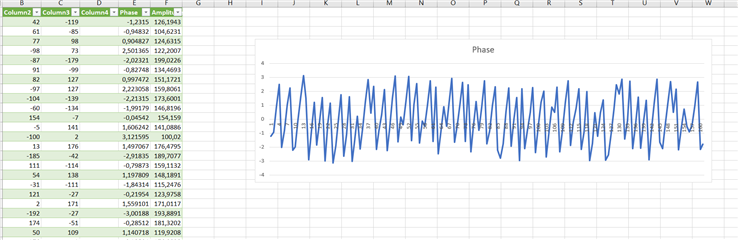

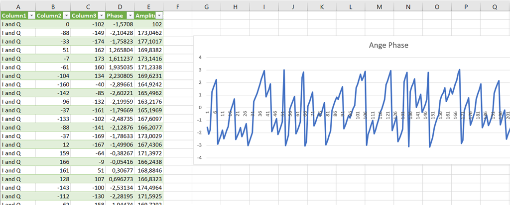

Why the resulting IQ samples look like random values?
  • Hi
    I didn't spot anything looking at your code snippets, but there are a few things to look out for. First off, using only 4 antennas are not great to get very accurate data, but I agree that it should yield better results than what you get here. Are you sure that the antenna switching and time between each IQ packet matches, so that it's getting picked up correctly. What kind of device is the advertising device, is it an nRF52833 DK for instance or a cusotm board?
    In what kind of environment are you testing this application? If you're in an office environment with a lot of BLE devices you might have some interference issues. Also, how are the boards positioned compared to one another?
    I would suggest checking out the direction finding example projects in the nRFConnect SDK for reference. Locator can be found here, and transmitter here.
    The IQ samples given here were received with only one BLE device.
    The boards were positioned as follows:

  • Sorry, I also forgot to mention the most likely reason you're seeing "random" values.
    Are you handling these values at all after you receive them? Raw IQ data won't make any sense by itself, as you always need to convert them to a vector. Then you can assess the vector after that. This is explained quite well here. Please check out the following formulas specifically:
    Some formulas calculating with I/Q Signals translating between polar and rectangular form etc.
    Peak Amplitude A = (I²+Q²)½
    Phase Angle ϕ = tan⁻¹(Q/I)
    I = A⋅cos(ϕ)
    Q = A⋅sin(ϕ)
    Converting IQ Data to a plain signal: I is the original signal.
    Euler form: A⋅eiϕ = A⋅(cos(ϕ) + i⋅sin(ϕ)) = I + Qi

    I calculated phase angles and peak amplitudes by iq samples and got the following results:
    As an experiment I have tried to receive iq samples on one antenna (the beacon and locator were stationary), the results look like this:
    But it seems to me that the phase should be approximately the same under such conditions. Am I right?
    Can you provide some details on the environment though?
    I tested the devices in a private house outside the city so that there are no other signals.
