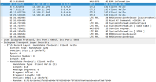

    I used nRF Connect Trace Collector to capture the trace files of the modem, so i could see if the encrytion has done, but i had some issues with it.
    Here is the trace as attachment, you can open it with wireshark and have a look at it and please help me find a solution for the issue.
    Honestly, I’m not quite sure what issue you have. Can you elaborate?
    Markus
  • Honestly, I’m not quite sure what issue you have. Can you elaborate?
    Actually i am having problems with DTLS connection and my aim is to be able to encrypt all data with a Pre Shared Key (PSK) before sending it to the server.
    Here is a sample of my code:

    Cedric
    The device initiates the DTLS handshake with a "Client Hello", which is correct.
    The problem appears to be the destination, which is 0.0.0.0. Which server/IP address are you trying to connect to? What is CONFIG_SERVER_ADRESS defined as?
