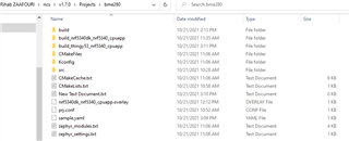

  • I see that the location that you have is C:/Users/rzaafouri/ncs/v1.7.0/Projects/bme280. Could you share a picture of all the files within this folder?
    Also, Do you have a bme280 folder in the location  C:/Users/rzaafouri/ncs/v1.7.0/zephyr/samples/sensor/bme280 ?
  • these are the files inside my project
    and yes there's another project called Bme280 under the zephyr samples
    it's the default sample package provided by zephyr
