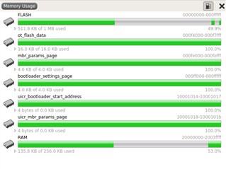

have also attached the memory view of my application :
MQTT-SN DFU Client
So my mqtt-sn client example integrated with dfu client example and interfaced with sensor after build takes 437.0K code area and 209.9K  Data+RO area as per segger studio. Now in Memory Usage out of the 1MB flash 511.8KB of flash is used up and 135KB RAM is used up.
I have attached the image for reference.:
- Now i flash MBR, bootloader, and the merged hex file generated using application hex and bootloader setting hex on my end device. I can see my device gets connected to the network.

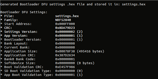

Here is my boot-loader settings file generated for my MQTT-SN based application:

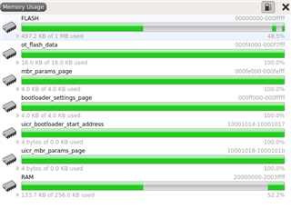

MQTT-SN DFU Client (To be updated via OTA)
- I have changed the sensor and built the project it takes approximately the same memory space as above. I have created a package file and started DFU process:

1. I think this can be the issue of flash memory as my hex file combined with other segments in flash make it around 500KB.
Secondly when I flash the end device with DFU Client example and then update it with MQTT-SN firmware 1. The firmware 1 starts running. Then on the same device running firmware 1, I try to update a new firmware MQTTSN firmware 2 and this firmware also gets updated successfully. So from this, I can also think there can be an issue with the creation of MQTT-SN-based DFU client.

    When you are using the Openthread bootloader, you need to fit all .hex files at once, so this may be a memory issue. It needs to fit the bootloader (Red line on the nRF Connect Programmer screenshot), bootloader settings pages (black lines) , the openthread persistent storage (the green line below the bootloader), the mbr (orange) and the old application, and the new. Please note that the thickness of the lines in nRF Connect Programmer isn't proportional to their actual flash sizes.
    With a flash size around 500KB you are on the very limit. A workaround for this is to perform two DFUs. The first one is just to upgrade to an application that takes much less space, so that you have room for the new one. You can try this if you suspect that the size is the limit.
    If that doesn't seem to be the case, when the update fails, does it look like the nRF52840 enters bootloader mode? Does the log from the DFU client, or the DFU server say anything? If you are using the DK, do the LEDs indicate Bootloader mode? Have you tried enabling logging on the bootloader project? If you do this, you probably have to test with a smaller application, since this requires you to increase the size of the bootloader, and change the bootloader's start address.

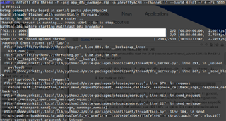

    Also now I am facing new problems as mentioned below. I am trying device firmware update on 4 devices:
    Problem 1: Sometimes when I run the Unicast DFU the server gets stuck at  " Thread DFU server is running... Press <Ctrl + D> to stop " . I have waited for 5-10 minutes too but no response.
    Problem 2: How to increase the data rate of DFU. It takes me around 30 minutes 482KB zip file.  I can see there is a -r parameter for rate but didn't find any valid value and doc of how to use it.  I have tried passing a few values but didn't affect anything.
    Problem 3: Sometimes when my DFU update is currently going on it gives me this type of error (Cannot convert the argument to integer). I have faced this issue very frequently, what can be the reason behind it?  And how to solve the same.
    Problem 4: Sometimes even after successful completion of DFU on the server-side the clients are not getting updated with the new firmware. So what could be the reason for the error in post validation?
    And what's the difference between the unicast (without passing IP address) and multicast DFU command,  as both take ff03::1 as address. Also the unicast in this case is more informative as I am able to see the IP address on which the data is getting updated, while in multicast I am not even able to check whether even any device is getting updated or not.
    Does it look like the DFU server is able to join the network when it is stuck in this state?

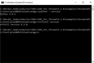

    I see that you are using python 2.7. Try upgrading to python 3.8. I have not seen this error in particular before, but at least the later versions of nrfutil is using python 3.8 as a preferred python version. Try the combo:
